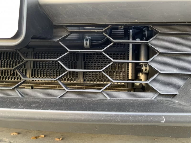

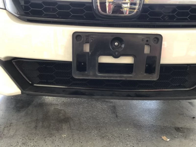

I ordered the Clarity screen and expect delivery tomorrow. Today I took a good look at the front and noticed a second grill with much smaller holes attached to the radiator. Our is a 2019.

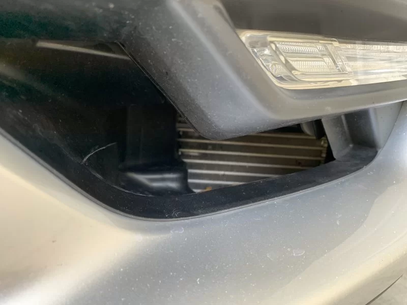

There is also an opening in the bumper/spoiler below the driver side head light with no grill at all and a radiator lurking inside. This may be another spot to add a screen.
@Landshark , the 2018 is identical to the 2019 photos you posted. I agree that the inner grill should provide a good deal of protection. Already bought the outer screen, so I'll put it on. I also agree that a more vulnerable spot may be the area on the driver side that you show in your second picture. I'll see if I can find a reasonable "screen" to cover that. Thanks for the photos. I'd probably never have even noticed either of these points.

That would be very cool. I forgot to mention that when I installed my screen I noticed that a large piece of brown paper bag had blown into the hole on the side and had to be fished out. Really awkward design
