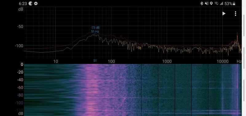

Hi,
There is a high pitched noise is my car. As you can see in the picture there is a high frequency peak that is really annoying.
I tried to find if it was related a system or the heat pump, breaking, etc without any luck.
Any one else having similar issues?
When I went for the last BMS update, I told them about it and they just said they couldn't hear anything.
What should I do?
Thanks in advance
First audio sampling I've seen in a question. Very cool. There are two high pitched sounds I have heard about in the Kona EV. First is of course the normal acceleration sound of the electric motor. Second is the reduction gear failure. I can't say if this is what your hearing but this question has been answered on the Facebook group and may have a forum answer here. There is a audio recording on the Facebook group that demonstrates the sound when the gear box is failing. They since had a complete failure and the dealer replaced it under warrantee. To diagnose a sound we could use some more details like , only when accelerating, or decelerating, or slow speed, fast speed with windows down or up. Is it all the time or just occasionally?

I will run the sound analyser today and I will test more conditions.
When I tested last time the noise was there when accelerating and braking all the time under 50kph.
