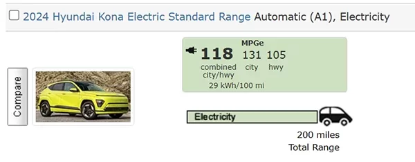

The EPA's laboratory range rating for the 2024 Kona EV is 200 miles, but how far you can actually go depends on hills, wind, temperature, precipitation, and how you drive. It's unlikely that a 2024 EV with only 6K miles has used up its battery.

Note @ChiSang quoted he purchased an SEL trim which has a range of 261 miles EPA c/w 64.8 kWh pack.
The SE version has a range of 200 miles EPA c/w the smaller 48.6 kWh pack,(scroll to 200 and 261 in the chart right column).
The smaller pack is not available in Canada.
I suspect the mileage will increase to estimated or better as the weather warms up- depending on of course the factors you mentioned above.
