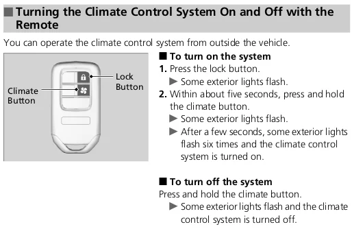

This morning we had our first frost in our area. I’ve had problems with the climate control button on my fab. I click it to initiate it on my car. The signal clicks and the lights flash on the car… then nothing! The only way that works for me is through the HondaLink app. Does anyone have advice for me? Thanks in advance.

Initiating the climate control from the Fob is a 2-step process...
First, you press the 'lock' bitton, then (within 5 seconds) you press and hold the 'climate' button.
Perhaps you know this, but it was not stated in your question, so I offer this as a possible solution...

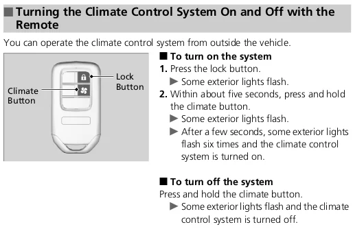

Here is a snip from the manual:
Thank you!! I was trying to Google this too and couldn’t find it. Thank you so very much!!
