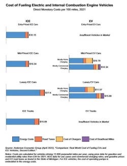

The report is using Michigan rates of $0.17/kWh for home charging and $0.43/kWh for DCFC. There's a 25% DCFC scenario and a 75% DCFC scenario.
Entry Level EVs do not exist because they are more expensive than a comparative ICE and the tax credits were not factored:
As stated at the beginning of this report, our purpose is to estimate the
real world costs of electric vehicles, and compare them apples-to-apples
with those for similar ICE vehicles.
Consistent with these principles, we do not include credits or subsidies
that are available only under certain conditions, only to certain purchas-
ers, or only temporarily. For example, the federal purchase tax credits are
only useful to those in certain income brackets, only for new vehicles,
and only during certain time periods
... essentially they are saying it's more expensive because they are including the cost of the charger into the equation. They are also saying that even if you have l2 charging at home, you're going to charge in a public charger once every 100 miles.
For most buyers, the cost of the "charger" is a one-time expense. I've had my SE for two years now, and I've only charged at a public charger once.
I also don't understand that if people are buying cars with 240 or even 300 miles of range now, why would they need to charge at a public station every hundred miles?
Costs of home chargers applies only to EVs used in home charging. We assume
an L1 charger costs $600 and L2 charger (with installation in 2021) costs
$1,820.40. These costs are amortized over 5 years.
It still costs $364.1/year (level 2 only) according to their assumptions. Works out to 28% of the $10.79/100 purposeful miles in the mid-priced EV category. Exclusively home charging at $0.17/kWh would bring down the cost to about $9.27/100 purposeful miles (12,000 annual miles).
The same reason why you need to buy another L2 EVSE for $1,820.40 each time you buy another EV.
