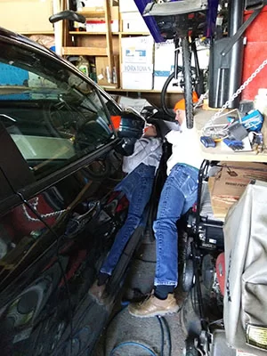

I learned the hard way that our Honda Clarity PHEV charges its 12V battery from the traction battery only when the car is "running" (ie. turned on).
Once, after not driving the Clarity for 3 weeks, the 12V battery became discharged (parasitic drains?). That's when I realized I couldn't put the electrified car in neutral and push it backwards without a working 12V battery.
The front of the Clarity sits under shelves on the rear wall of our tiny garage. There is no way to raise the hood more than about 7 inches when it's parked there. Also, there is almost no space on the right side of the Clarity because the lawnmower and snowblower are parked there.
Here I am crawling sideways next to the Clarity to connect my charger to the battery under the hood I could raise only 7 inches:
Looks painful, my guess is you have removed the shelf (once able to move the vehicle) or start backing in:D
The shelf remains, and the Clarity's the trunk is higher than the hood, so I can't back it in.
The problem arose because my MINI Cooper SE is so much more fun to drive than my Clarity PHEV, which is mainly used for infrequent long-distance trips. As a result, the Clarity was sadly neglected and it protested by discharging its 12V battery.
My solution is to remember to drive the Clarity more often to ensure its 12V battery--trapped below that low-hanging shelf--stays charged. Actually, I could just turn on the Clarity for a half-hour to charge the 12V battery without ever driving it, but it is a great car and deserves more respect.
