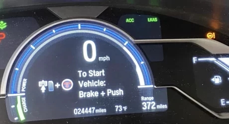

2018 Clarity Touring: I can't turn the power off on my car. There is a warning light on in the upper right corner for the "Electric Power Steering(EPS) System Indicator." But the manual does not offer instructions on what to do to shut off power. To the car? Any suggestions?Screen Shot 2022-03-27 at 2.48.10 PM.webp
Thank you, Robert. I went back to the car and kept pushing the Power button. It finally turned off. But now I can't recall if I had my foot on or off the brake. But I will keep your suggestion in mind if this happens again.

Looks like it is in accessory mode. Did you try pushing the Start/Stop button without pushing the brake?
Actually ON mode (two presses of the power button without pressing the brake pedal)
