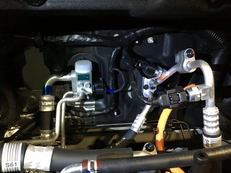

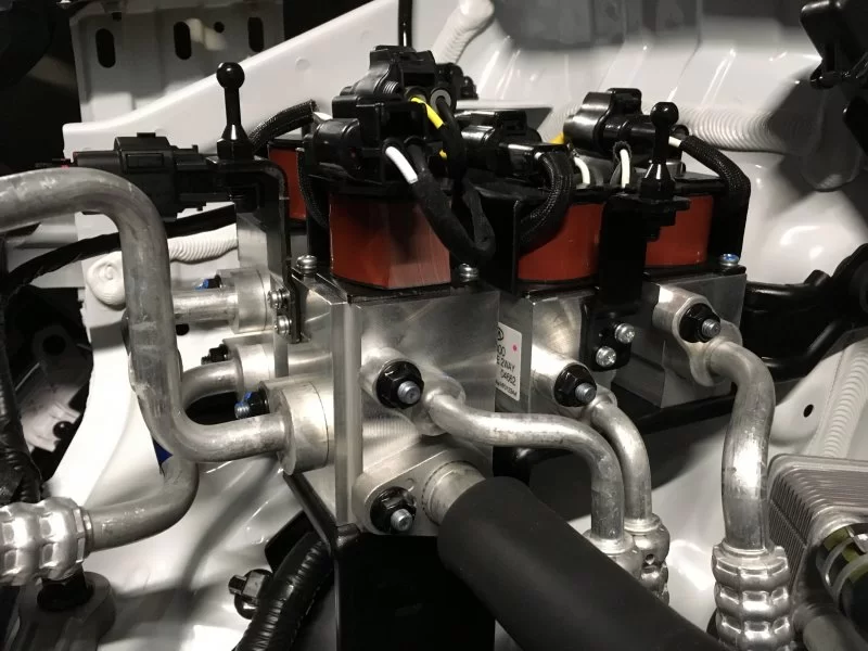

I expect it's the same compressor as it wouldn't really know or care how it's plumbed. As for cost, I think there are a few pricey parts including both a condenser and evaporator in the HVAC air path, as it needs both to dehumidify. It has also been mentioned by others that the PTC heater may remain as a low-temp backup, so that savings may not be there. I can't confirm that but do note that the power cable is present (orange cable in the photo).
View attachment 8658 View attachment 8659
