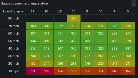

This is actual data from a Tesla Model Y, but it is likely that similar principles apply. The temperature is in Centigrade:
It is interesting to note that the "optimum" temperature is 25C. Above, or below 25C and the range deteriorates.
The best performance occurs at a speed of 40 mph and a temperature of 25C.
This vehicle has an EPA rating of 279 miles which it can achieve (or exceed) up to 70 MPH+.
