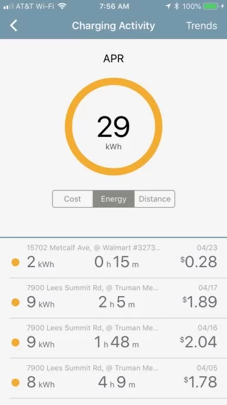

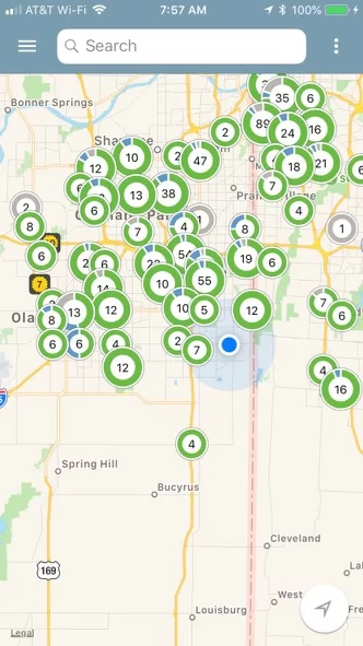

Am fortunate to live in a city with over 1,000 public charging stations and have used a few of them (more out of curiosity than need). As the following screenshot show, I've not had an issue with any of them.

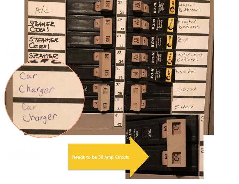

The first place I'd check is the fuse box. The breaker should be a 50 AMP combination like this:

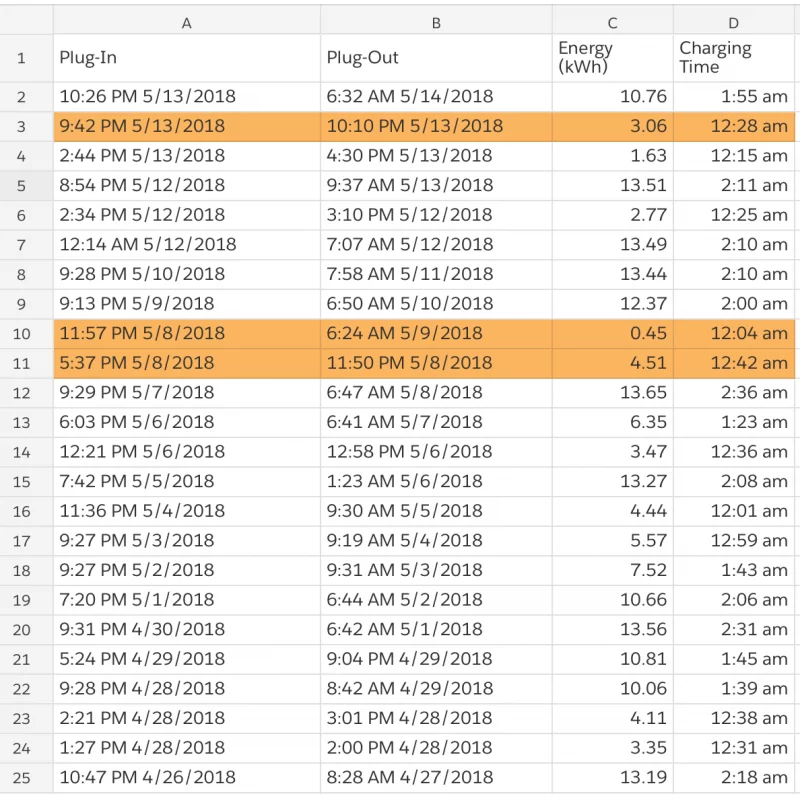

I am having similar issues also. Seem like level 2 charger (juicebox) is not charging it past 13.56 KW. The car is usually drained to 0 each day, and when we operate the next day, EV estimate is always around 40-43 (missing a few ticks in battery gauge). Hondalink app in Android shows battery is charged to 100% each morning, but when I turn on the car and check the energy level, it's always about 80-90%.
There are two instances where juicebox thinks it's got unplugged event thou we didn't. There's an instance on 5/9 where it only charged 4.51 + .45 for the night... Will be taking it to dealer and see if they know what's up.
