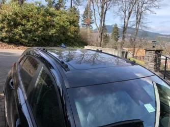

I’m going to get bike roof racks as well. I have the roof crossbars but haven’t bought the bike attachments yet.

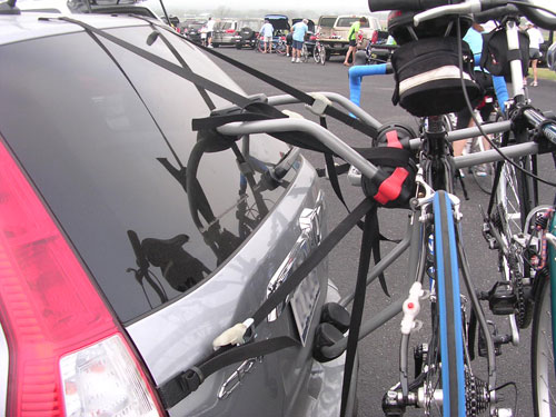

In the meantime, you could use a rack that hangs off the back - they're not ideal but the better quality ones, like Yakima, work well. I used it on a prior car with heavy mountain bikes and it didn't damage the car, was very stable, and reasonably easy to take on and off. And you can actually operate the rear hatch with the (empty) rack still mounted. (Watch your head closing the hatch, don't forget about it < voice of experience.) Just don't get the cheap ones.

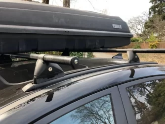

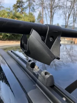

More to your point, I did install roof racks onto my Kona EV limited, onto which one could attach bike racks if desired, and I describe it in this thread: https://www.insideevsforum.com/community/threads/roof-rails-or-racks.5120/
They start with low-profile roof tracks (about US$300 installed) onto which towers and crossbars can be quickly attached and removed with a flip of the lever, and they are super strong (I used them for over three years on my old car, and drove highway speeds with a roof box and surfboards strapped on). Rack Attack can hook you up if there's one near you.

If you can't wait, you can use a strap-on bicycle carrier on the rear as a temporary solution. But take care with that, and strap it on tight so it doesn't rub, which could mar the paint job.
