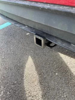

This post on Reddit found a hitch that only requires cutting the underbody shield rather than a very visible hole in the bumper. It looks to be pushing up a bit on the black plastic part of the bumper but it's probably the best minimal cutting options at the moment.
Part number X7290-B (I think it's this)
Definitely go with the hitch and have a pro install it. I wouldn't personally worry about the cut in the bumper.
I've had a good experience with OutMotoring's very knowledgable SMS text support.
