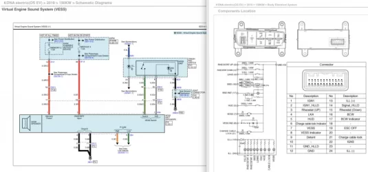

It's really going to be quite simple to add for anyone with a hobbyist background, or even by a local auto electrician if needed. One normally-open pushbutton switch and one 200 ohm resistor, from the pin 7 VESS connection to a nearby ground. The hardest part might be removing the connector to tap into the wire as the switch panel is secured by screws at the back. I have it on good authority that the wire is present even when the button is not.

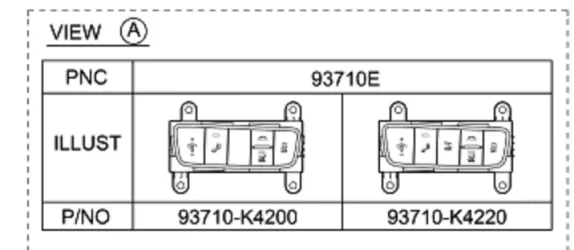

When adding a switch that your car doesn't have, by far the most aesthetically pleasing way to do it is to replace your switch block with the OEM switch block that includes the function that you want to add. (I've done this on my Tundra.)
That picture above is of a single part, with all those switches together. Buy that, and replace your existing switch block.

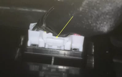

A shot from under the dash of the connection at the rear of the 'crashpad' switchblock. I would assume the latch is pressed in to release but I'm not certain. Tapping into the wires could be done by extracting the pin and carefully soldering a fine gauge stranded wire onto the strain relief part of the pin. Or, just tap into the wire higher up and tape it up.
To buy a whole new switchblock I think you might have to get one from an EU-spec LHD version, same as mine but a mirror image. A suitable pushbutton is easy to find at an electronics retailer, this one needs a 12mm hole.

If you don't want to take the crash pad apart an alternate would be to run a single conductor small gauge wire to pin 3 of the VESS module connector and ground the switch end thru a 200 ohm resistor at the switch location.

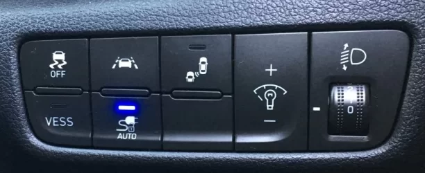

As one who has the factory-installed switch I can say that it has proven to be very useful in practice.

It was kind of disappointing not having that feature on Canadian spec, and was and still is one of my priorities on my to do list.

I was playing with the website where they sell parts. There are a few variants of the switch block.
93710-J9110-TRY Kona. Without blind spot mntr.
93710-J9120-TRY Kona. With blind spot mntr, without head-up display, without lane assist.
93710-K4200-TRY Kona Electric. With blind spot mntr, without head-up display, with lane asst, with ev, black.
93710-K4200-YPK With blind spot mntr, without head-up display, with lane asst, with ev, gray.
93710-K4220-TRY Kona Electric. With blind spot mntr, with head-up display, with ev, black.
93710-K4220-YPK With blind spot mntr, with head-up display, with ev, gray.
They run around 100$. But there is no guarantee that they have the VESS switch - the parts website just has crude drawings with not a lot of detail, but I see no sign of such a switch.
