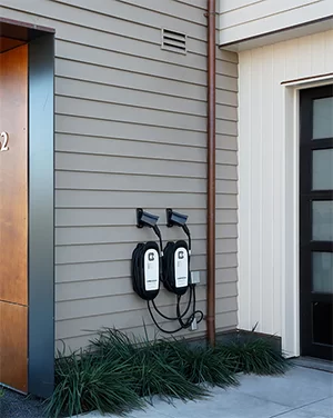

This ClipperCreek Share2 pair of 40-Amp EVSEs share the same 50-Amp line. The pair costs $1710, which isn't cheap, at $855/EVSE. If you already have a 40-Amp line and an EVSE, perhaps the 2nd 40-Amp line and a more reasonably priced EVSE would be less expensive than the Share2 system.
One thing surprised me on ClipperCreek's Share2 page: Mounting 2 EVSEs right next to each other in a corner might make it tough to charge 2 EVs at once.
