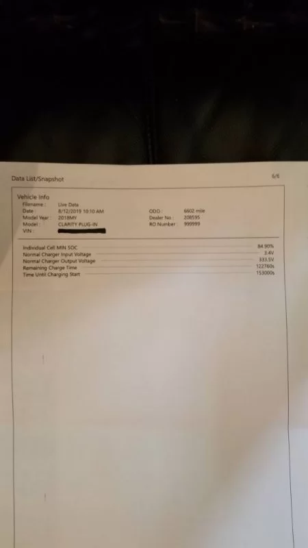

Took our Clarity in today to have SB 18-090 installed. I asked the service manager if he would mind performing the battery capacity test (since I didn't get the PDI with my car a year ago). He said "sure !" It literally only took 5 minutes to print the results.

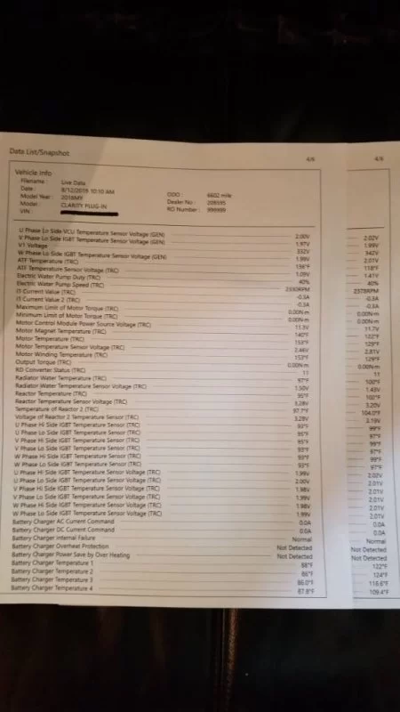

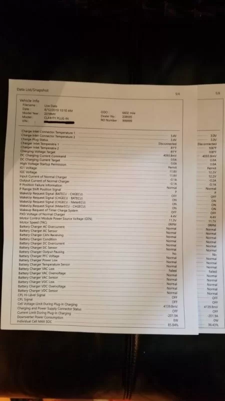

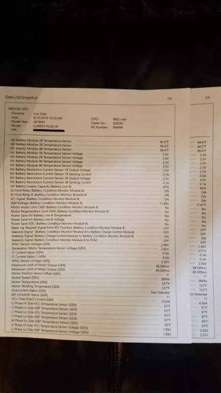

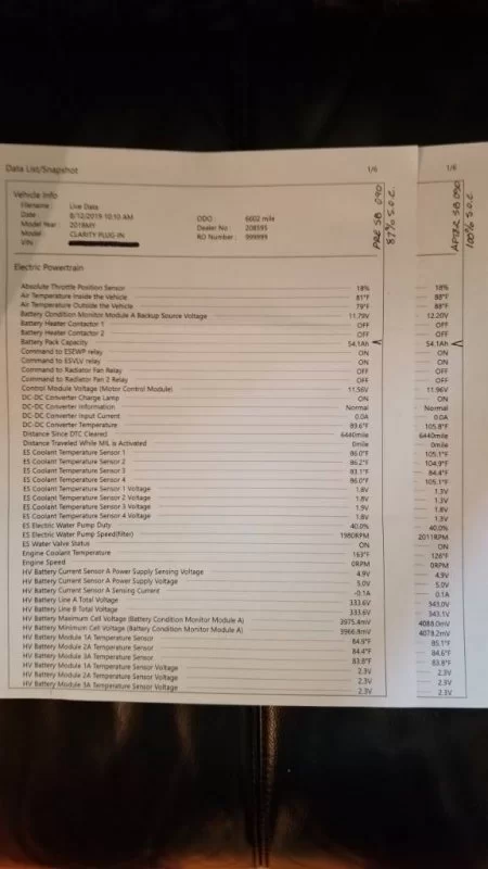

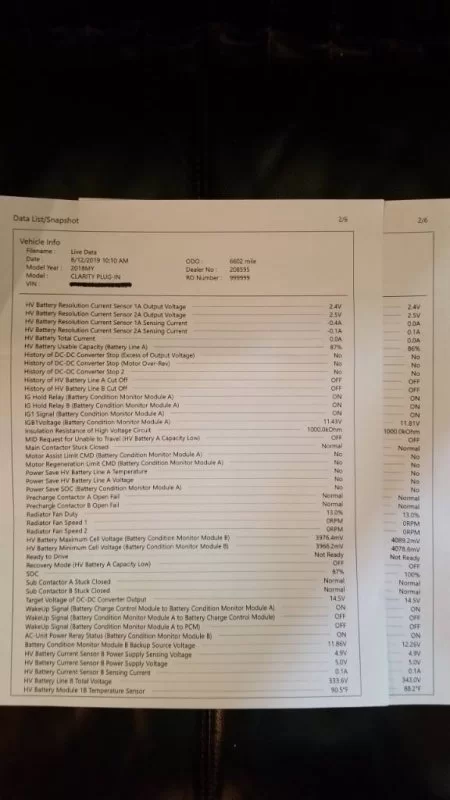

He offered to do it again after the SB work and charging the car to 100% (they actually had a 30A L2 charger) just for the heck of it, to see what differences there were. Attached are pics of the 6 page reports (left side pre SB, right side post SB). Took the dealer about 1 hour to do the SB.
The battery capacity came in at 54.1Ah. Since I garage (unheated) my car 3 months out of the year in the Michigan winter the manager suggested I bring the car in for the complementary tests before I garage it and then again in the spring to see how the inactivity affects the test items. How is that for service?
