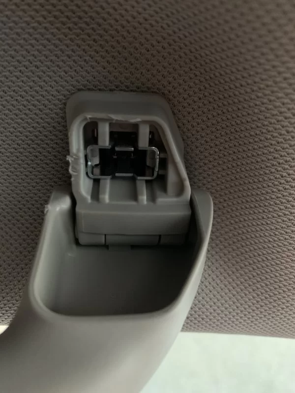

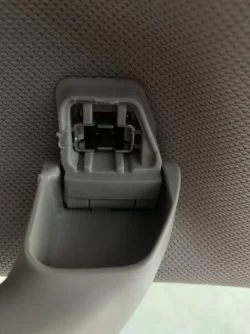

Here’s 2 photos. The cap pops off. It may take some prying from both sides. There looks to be a metal clip that might be removed with needle nose pliers that would release the handle.

Much thanks @Landshark That is exactly what I was hoping to hear.
I had found procedures on the web for Honda Fit and older Accords that are very similar, but I had so much difficulty trying to pry them out on the Clarity, I was afraid they might be a different design, and I might damage them. Good news. You got to love this forum for helping each other.
