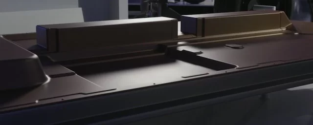

Shortly after their battery expert bragged about their huge, pouch cell, I had something better to do. The reason why:
  • large area pouch cells have a thermal management problem - it tends to have hot and cold spots on the edges and when any part of the large area fails, the whole cell fails. Large formats have isothermal challenges.
  • mass of smaller, isolatable cells handles failures softly - fewer large format cells means if one fails, the pack is screwed. In contrast, mobs of smaller cells handle problems by isolating the failed cell and continuing the trip.
I'll review the playback later but when I saw the 'hump' in one of their battery examples, I knew they were as clueless as their EV1 decisions.
In order to look at battery, you need look at the minimum at : amount of charge it will hold (a proxy for range), charging time, deterioration over a period of time (longevity), size and dimensions etc. (this is being simplistic)
GM seems to have been more interested in quicker charging times, a form factor that will allow it to be stackable (being rectangular you have a higher packing density) and hence better range. For that they have sacrificed longevity. The cylindrical form does have some advantages. There is some talk about thermal management, but they want to compete on range and charging time.
Oh Well!!!! But BTW GM's share price jumped 2.5% on the news of their big investment in EVs, to $31.21, as of 3 p.m. in New York.
I appreciate their effort but battery thermal management is not trivial. I need to review the playback.
The reason is our Tesla swing the battery temperature about 20C between 50C optimum charge and 30C optimum operational temperatures. This transition is where a thermal gradient can lead to a bad result.

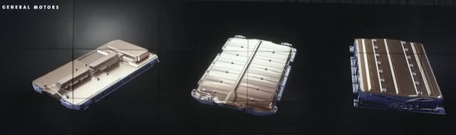

So here are a couple of images:
Here are there different pack configurations showing GM's approach. Notice the inconsistent "modules" from the three pack configurations. But this is what 'raise my eyebrows':
They have a center 'tunnel' of battery cells, not their 'module', to replicate the legacy drive shafts that screwed up cars since forever. DUMB!

That is hilarious, a flat floor would have a better approach like these 2 American icons:
https://www.hagerty.com/articles-vi.../design-evolution-olds-toronado-from-cord-810
