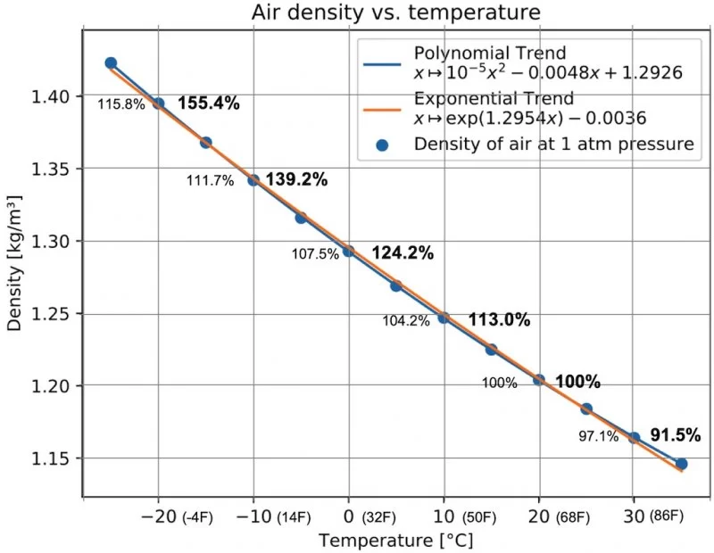

Some basic physics can help. If we keep the rolling drag constant by keeping the tires at a constant pressure, then aerodynamics defines the performance. Aerodynamic drag is driven by the air density so I copied this chart from Wiki and added details:
The modifications:
  • added a grid
  • added the (fahrenheit) to celsius values
  • used 20 C / 68 F as a Standard Day temperature (what I use for performance benchmarks instead of 15 C (59 F))
  • added the "drag %" and "power %"
So keeping the same tire pressure (add air when colder) and speed (62 mph is a good number), use that particular consumption in Wh/mi and multiply it by the "power %". For example:
  • 229 Wh/mi = 250 Wh/mi * 91.5% -- the warm weather, 86 F advantage
  • 250 Wh/mi = 250 Wh/mi * 100% -- Standard day, 68 F
  • 282 Wh/mi -- 50 F day
  • 311 Wh/mi -- 32 F day
  • 348 Wh/mi -- 14 F day
  • 389 Wh/mi -- -4 F day
This was a 'back of the envelope' analysis. Another, non-dimension number, Reynold Number, can modify the power so I've posted the cube. This was mostly to give a math model, the background, to estimate the range loss as a function of temperature at a given speed with tire pressure kept at a constant value.

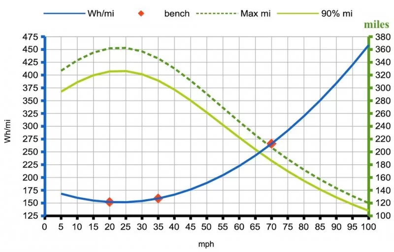

BENCHMARKS
The blue line shows the Wh/mi from earlier benchmarks. Reading up the 60-65 mph speed, we're seeing ~230-235 Wh/mi:
NOTE: This chart was made using Tesla inflated tires, ~45 psi in part to match what an OEM Model 3 would achieve. Fully inflated, the blue curve is lower and range longer.
A math model needs to be validated. So I drove both directions on a 20 mi route with the tires at 50 psi before dawn at 34 F (1 C):
  • 276.6 Wh/mi measured / 124.2% ~= 223 Wh/mi @68 F (20 C)
Now I wait for a noon to 2 PM window with a temperature close to 50 F (10 C). Repeat the calculation and see how close we come to "223 Wh/mi".
