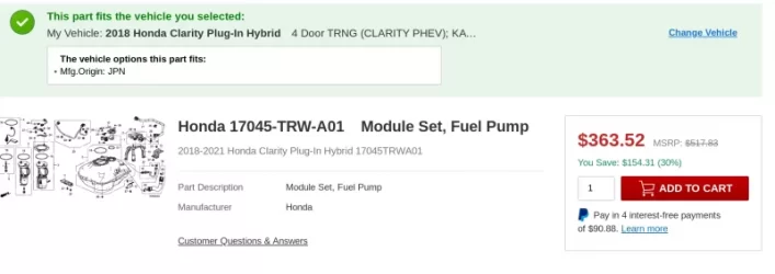

FYI...One can find the correct fuel pump online if so inclined.
Personally, If I decide to take a long road trip in the Clarity this summer...I will purchase said pump and replace myself. Not a real complicated procedure and should take ~2 hrs start to finish.
$400 vs waiting for Honda with an unknown replacement date.
As of this writing I plan on local driving only so will wait on the Honda fix.
Just an option...please don't hate on the messenger. Knowing your options is a wonderful thing
Have a great day!
Do you know if that pump has a new part number? I'd hate to pay $363.52 to get the same pump that's already in my Clarity PHEV.

New part A01 vs original A00 or so says Honda.
Hope this helps.

The recall is for the 2018-2019 model years. The A00 part was the part used on those cars. The 2020-2021 uses the A01 part which presumably has been in production since late-2019.
What is peculiar is that Honda states in the Recall letter that a replacement part is not available, but should be available this fall. Yet the A01 part is readily available.
Is Honda feeding us a load of crap, or is the A01 part not a suitable, or approved, replacement.
