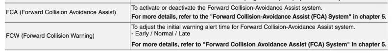

I turned something off, FCA I think, and now I just get a beeping from what I think is the FCW.
