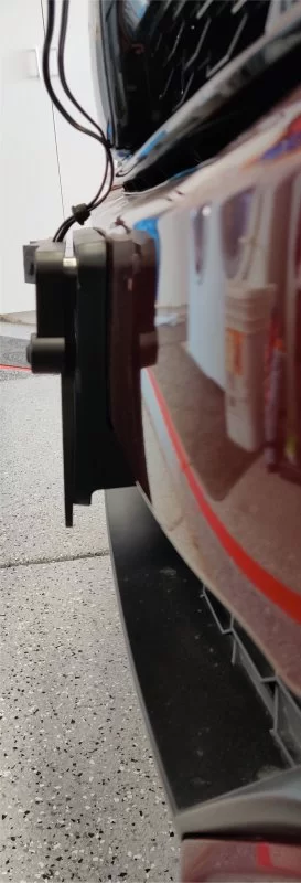

License plate: I added the wedge so it is more vertical. At the top of the wedge is a U shaped opening designed to let the wire through. They expect it to go straight back through the vehicle. I opted to cut the base of the U off so I could fold the wire down (a 180 degree bend) and through one of the honeycomb openings behind the plate. The coat hanger once again saved me. I used it to reach down and hook the wires to pull them up to the engine bay.

Wire coming out of top of license plate bracket then bending straight down to reach an opening in the grille.
Plate from side.
