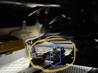

Folks, FYI, the 2023 SE underseat cable is slightly different from the other models.
Attached picture for reference.
When you pull the grab level behind your seat back, the black bracket within the blue box is suppose to pivot backwards and the seat slides.
I noticed that my driver seat black bracket did pivot while the passenger seat did not.
I tried to trace the cable to identify the break points but was not successful. Maybe the cable imbedded behind the seat back is broken but will not be able to confirm until I decide to unzip the back of the to look at the cable. Looks like a visit to the dealership is needed.
