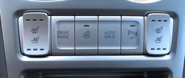

Do you have the P))) button as described in the video? I also have an Ultimate and I do have the button, so I assume i have the front sensors. Otherwise, what's the button for?
Yes I have the "P" button but it disables the reverse parking distance warning.

The way I see it is if you have the heated steering wheel and parking sensor switch on the center console, than you have an Ultimate model which includes the 4 front sensors. One under the charge port, one by the tow hook port and one each under the headlights. Same size as the 4 back sensors in the bumpers about 3/4" round. If you don't have the front sensors and you have the buttons than Hyundai owes you a new nose cone.
If you have the sensors and still don't work with the button on (blue light enabled) than take it in - maybe they never hooked them up.
Sorry for stating the obvious I just don't think that has been mentioned yet.
I got excited when I read this, but the US versions does not have front sensors. That button is to turn off the rear sensors.
