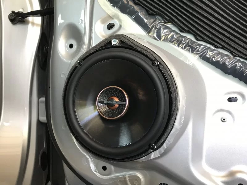

Just a quick update FWIW, after some time, I found the Infinity door speakers too bright.
After more discussions with Crutchfield, now trying this speaker:
Kicker 44KSC6704 6-3/4" 2-way Speakers
First impressions are much better bass and midrange in comparison to the high end. Also, the sound settings seem to be more useful now to fine tune the three ranges.
Still less performance than if an amp and maybe even sub woofer were installed, but many times better than the stock speakers.

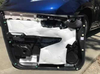

How difficult is it to remove the door panels? Any problems with rattling or squeeks after putting the doors back on?

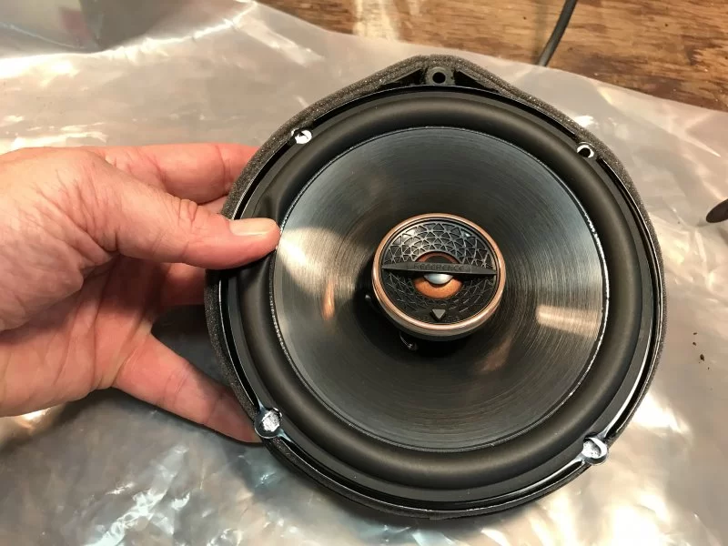

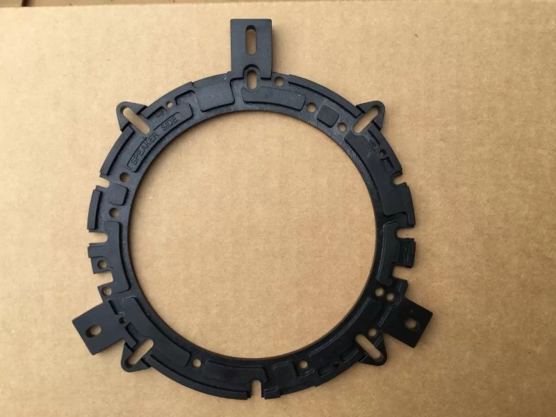

I'm upgrading the speakers on a 2019 touring, and hoping someone can provide more details on actually mounting the speakers to the door. Did you just drill new holes or somehow attach a backing plate? The plate that came with mine (6532ix pic attached) is different, so wondering if I got the wrong model? Lastly, did you use a baffle or sound deadening tape on the metal around and behind? thanks in advance for any help....
These are the parts I used for my first 2018, no drilling needed, they just fit in to the existing openings (Crutchfield). I think these types of parts are also on amazon or eBay.

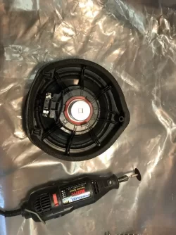

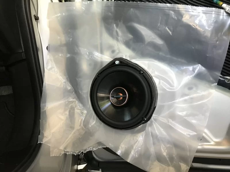

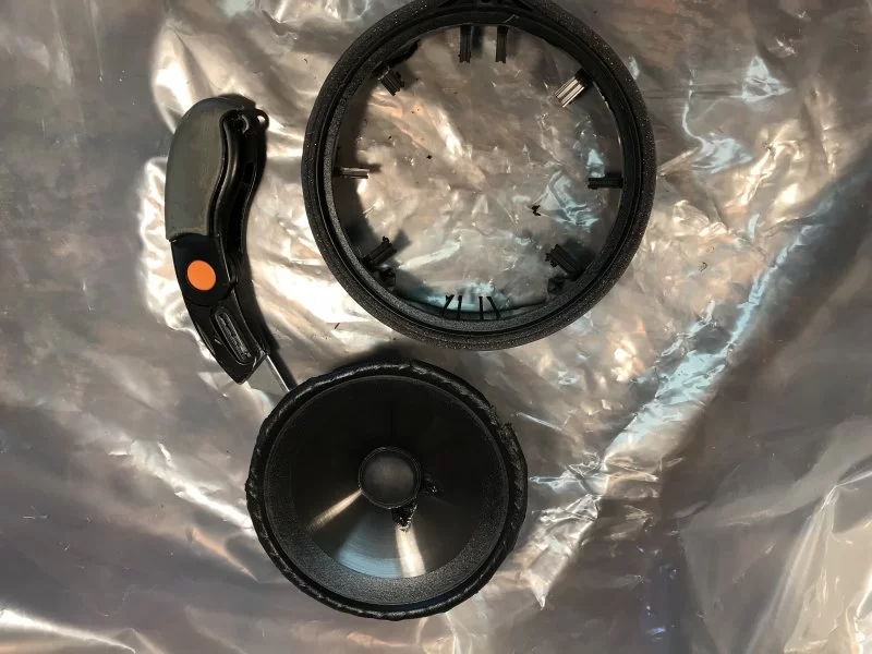

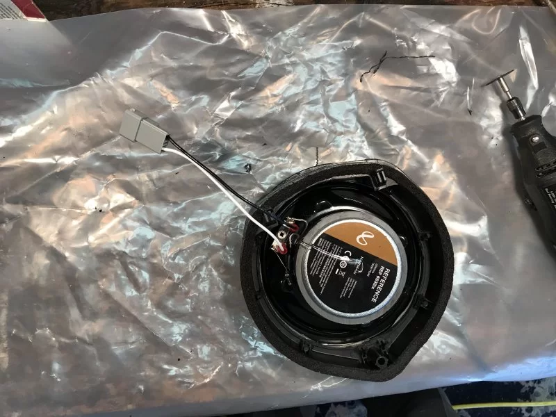

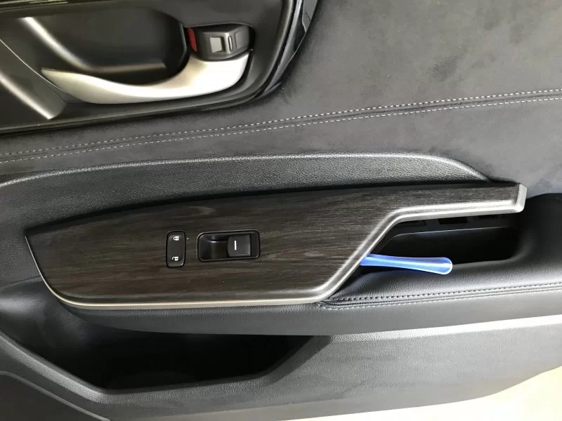

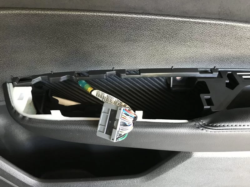

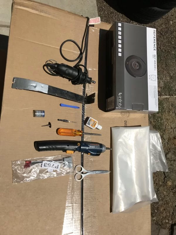

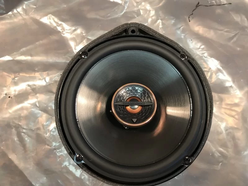

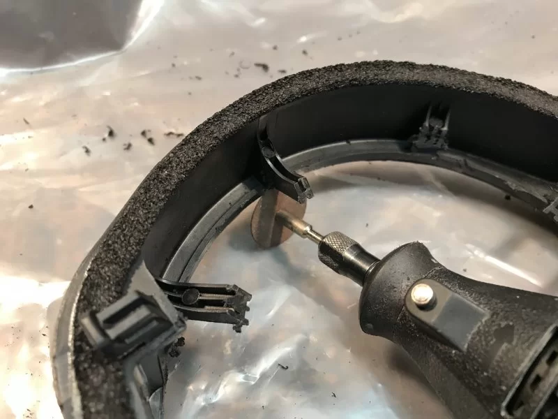

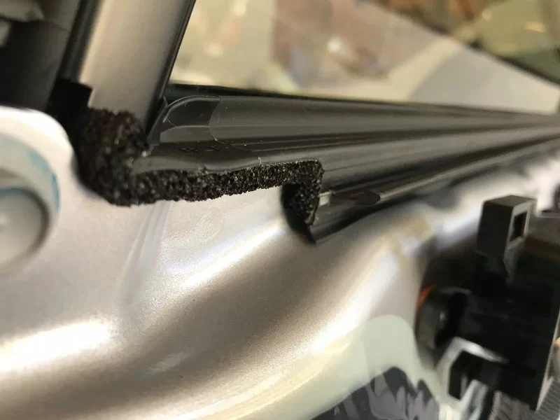

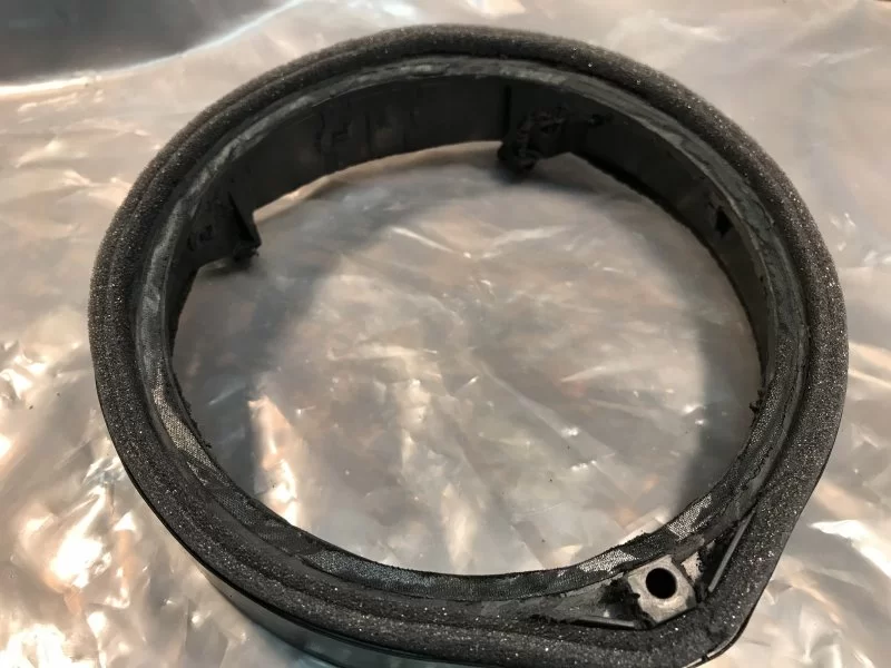

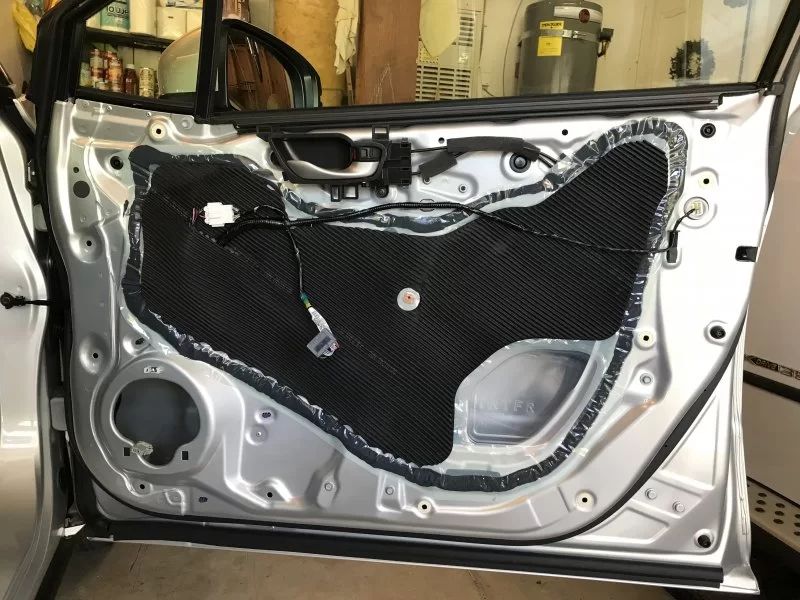

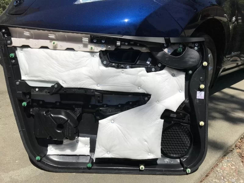

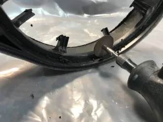

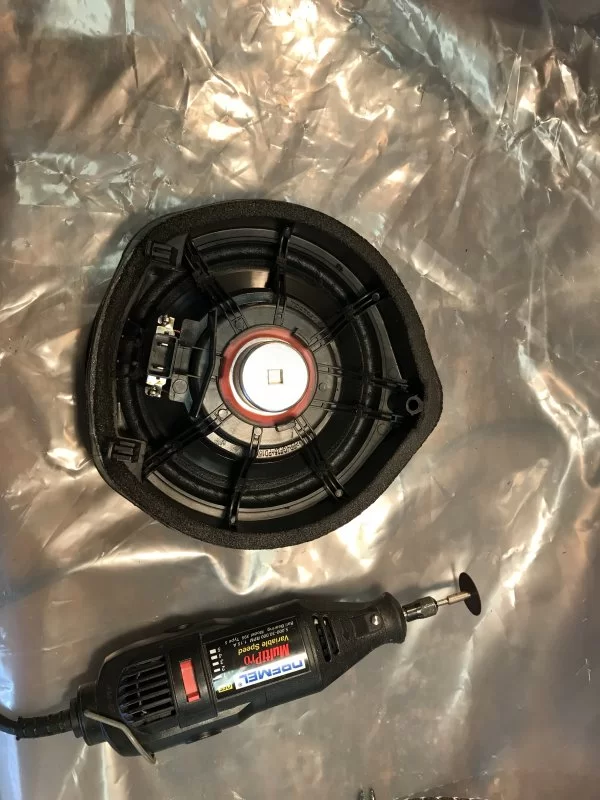

Thanks for the info. Impatience got the better of me, and I wound up customizing the OEM mounts, which turned out fairly well I think. For anyone interested in going that route, some pics are attached of the process. The good news is that the Infinity speakers did clear up the muddy midrange, but at the expense of the bottom end. As small as those magnets were on the OEMs, they actually had decent bass. Rather than try different speakers or put in a sub-woofer, I'm thinking of putting some heavy bass woofers in the back doors. Am I nuts, or might that work? Any suggestions on 6.5" speakers with heavy bass?
