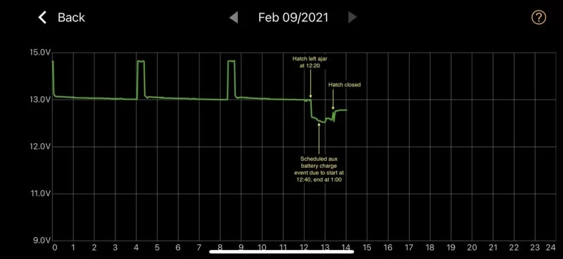

The recent BMS update increased the frequency of the 12v top-up from every 24 hours to every 4 hours. AFAICS there is no measurement of battery voltage to top-up as required, it just does it blindly every 4 hours regardless.
Thanks Mike! That would make sense. I haven’t actually timed it as such but it seemed more frequent than that. Saying that I may go and park the car outside one of my living room windows and keep an eye on it.
It’s about as exiting as watching paint dry. Seriously though, it would put my mind at rest if the BMS has made the change. What would we do without these posts! Thanks again :)
Bob, install a BM-2 Battery Monitor and you can checks the logs at your convenience with your smartphone.
