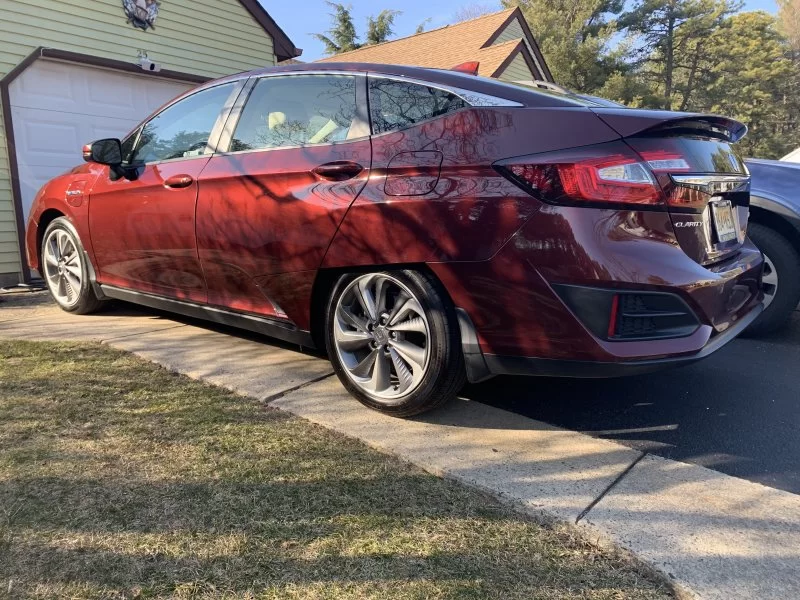

Hi,
I have the factory Mudguards installed. Removing the bumper wasn’t required…..

Must not be OEM, because the job couldn’t be simpler. I did mine while the tires were off for balancing/rotation…..THAT helped a ton. No bumper cover involved though
