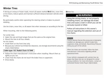

It may be easiest to identify the part and order it online. FWIW: here is the guidance from the manual regarding the use of tire chains. CA5711F4-11B5-4F59-A284-C909B38CD1C4.webp
