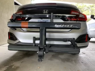

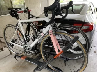

We had a Küat rack that fit a 2” receiver for our Jeep. I can’t imagine 2 bikes and the rack weighing anywhere near 300lbs. Keep in mind that 300lbs is the rating for the hitch, there’s no tongue weight rating for the vehicle.
Use caution when transitioning from a driveway to the street. I’ve grazed the hitch once or twice. With the rack extended out the risk of scraping is increased. You could add a hitch riser, but I’d recommend just being aware of the issue.
