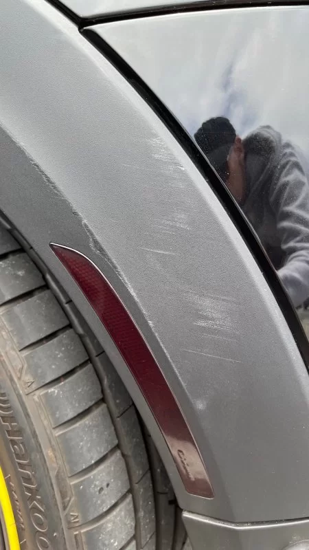

I discovered that my rear driver-side fender was scratched up today. I don't think I did it myself, but it wouldn't be the first dumb thing I've done.
I'm wondering if there's any magical car-care product that'll reduce the appearance of this, or if I'm going to have to replace it. Replacing is a bit of a bummer since I had the side marker tinted.

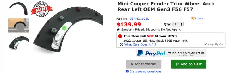

I found this part which looks right. It has a warning that it won't fit, which I think is probably incorrect. At least it's not too expensive. Not sure how to install, though. If it requires taking the wheel off then it's probably not a DIY job for me. Maybe a 2yr service project at the dealer.

Direction of the swipe looks like it went from front -> back at a curve like a white car was reversing out and swiped the fender trim. Impact is largest on the area on the side marker face. If that's the case you could buff out the clearcoat and white paint, but you will have to live with the plastic scratches.
Just be happy that your rear quarter panel is undamaged. In many luxury brands that could be a $15k+ job for replacement (have to cut and re-weld the unibody).

The SE sits a bit higher than the regular F56 supposedly and therefore has slightly bigger wheel arch molding to fill the gap to the tires/wheels.
