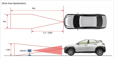

The FCA is clearly designed with slow pedestrians crossing your path, or vehicles on the same track, in mind. @KiwiME 's diagrams show a work area going forward only 8m (26ft) from the front of the car - at 60mph (88ft/sec) you would cover that in 0.3 secs.

Limitations are shown here and do not mention wildlife. The deer may have blended into the surroundings or simply appeared too abruptly for the camera to pick up. The radar is designed for larger moving objects such as vehicles.
