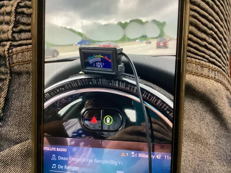

I’m monitoring temperature on top of the engine today I read 105” and outside was 85” once I park in my garage where temperature is now 78” I plug for charging and a fan from cooling system start right away .I stop charging bc I can charge when temperature of engine goes down .I can’t monitor HV battery but could be the same 105” like engine I really don’t know .I’m doing this for curiosity what is going there and hope the sensors take care of a cooling needs of SE as did today
.I heard that fan first time today and bc I charge a car at night 12-8am only a car is always cool as my garage temperature summer 80” winter 60” that’s why my cooling system never start with those temperatures is indoor garage in a ranch type of a house.SE have 1900 miles since January 2022.
I’m monitoring temperature on top of the engine today I read 105” and outside was 85” once I park in my garage where temperature is now 78” I plug for charging and a fan from cooling system start right away .I stop charging bc I can charge when temperature of engine goes down .I can’t monitor HV battery but could be the same 105” like engine I really don’t know .I’m doing this for curiosity what is going there and hope the sensors take care of a cooling needs of SE as did today View attachment 17404 .I heard that fan first time today and bc I charge a car at night 12-8am only a car is always cool as my garage temperature summer 80” winter 60” that’s why my cooling system never start with those temperatures is indoor garage in a ranch type of a house.SE have 1900 miles since January 2022.
Car was sitting in garage in 78” temperature for 9 hours and from 105” temperature went down to reach 83” temperature Right now I’m going to charge at L2 to see how temperature will rise when I achieve full charge . My probe to read temperature is glue to top of engine .

In 2 hr on L2 temp. Raise 14 “ as L1 is much slower the temp.for sure is not raising that fast.When my reading on temp.show me 105” driving with Max. AC and about 55 M/HR my plan is to remove engine cover just for summer bc this 105” is not dangerous but I don’t like it optimal temperature for EV is between 80-90” .What I read about EV likes just a body temperature which is optimal.98.6 “F .I just wander in Arizona .NM.CA .when you driving your cooling system works constantly.In NY I have 90 F . the most .
