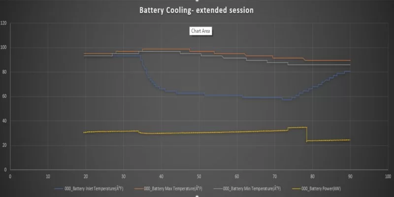

I charged from 19 to 90% in a longer session on a 50kw charger (which currently has an issue and only supplies up to 35kw). Cooling seems to always trigger at 98.6 F / 37 C and shuts off 91.4 F / 33 C..
This is with the 960 BMS update, is that correct?I charged from 19 to 90% in a longer session on a 50kw charger (which currently has an issue and only supplies up to 35kw). Cooling seems to always trigger at 98.6 F / 37 C and shuts off 91.4 F / 33 C..
correct, I had it done a little while ago..This is with the 960 BMS update, is that correct?

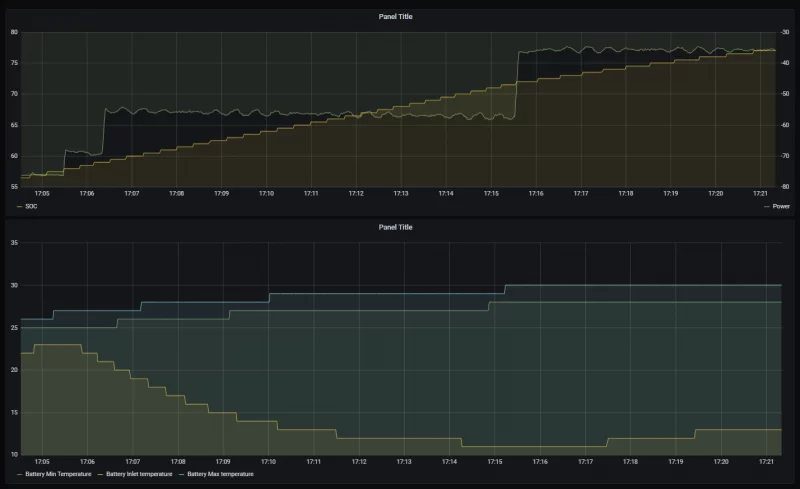

Interesting. I have to try on a EA charger soon to see if this is the case on my Kona..I am guessing there are different temperature set points depending on the charge power.
During my last charge, cooling started immediately as I started the charge at 76kW while the battery max temperature was 26°C/79°F.
Then the cooling stopped exactly at the same time as the charge tapered from 57kW to 35kW at when hitting 72% of SOC, the battery was at 30°C/86°F at the time.
See attached screenshot.
