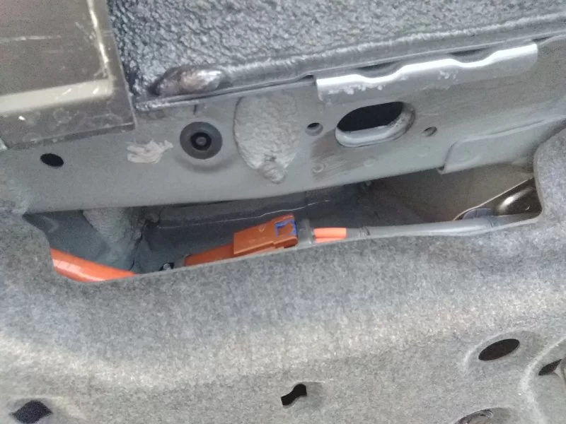

The orange HV cable is located under the driver side rear door. Is this normal for the cable to be exposed? Thanks.

That photo looks dismal! As if the car assembly hadn't been finished. So, what happens if some kid sticks his fingers in there?
Why the opening? The paint, rustproofing or whatever it is looks uneven and unfinished, too!

Many EVs (possibly all with regulations) have extra terminals in the orange HV connector which break a detection or safety loop when an HV connector is opened. In some cars, an open HV safety circuit disables the HV system, resettable by a dealer.
