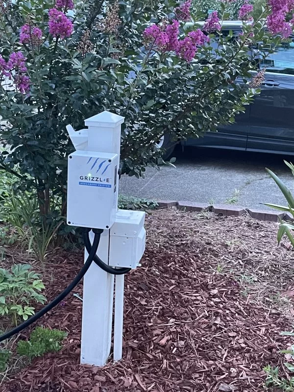

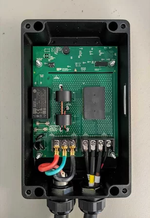

I chose the Grizzl-E in large part because of the engineering, based on the InsideEV Grizzl-E review. I got it for cold weather reasons, and one can appreciate the quality design:
