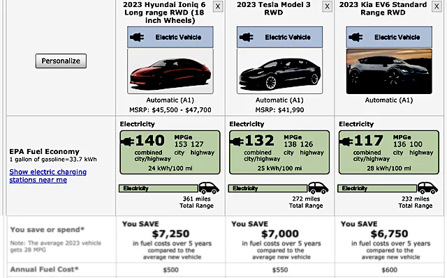

So starting with Fueleconomy.gov:
Hummm, the Ioniq 6 shows excellent efficiency better than the Model 3. But the EV6 seems significantly 'out of its depth.' But let's compare their drag force.

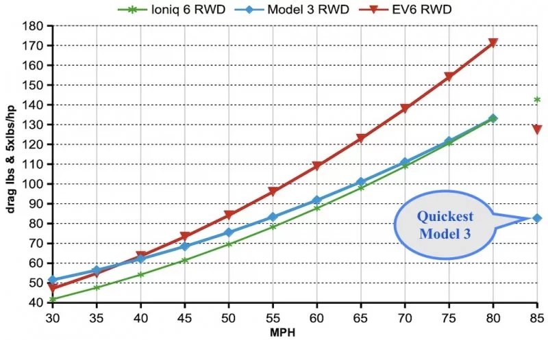

Using the EPA Test Car Database, we can plot the drag force as a function of speed:
- Ioniq 6 - lowest drag across both low and high speed range. But the weight/HP ratio makes it the slowest to accelerate.
- Model 3 - higher drag at lower speeds which is probably due to tires used to handle the higher power (i.e., weight/HP) of the other two. It also has more electrical overhead with dual, high performance controllers sized to process Full Self Driving as well as Autopilot.
- EV6 - highest drag that rapidly rises above 40 mph and second best weight/HP ratio. It would be better in City than Highway travel.
