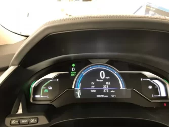

As shown in photo EV showing 0.0 and car never drove into EV mode.
Finally I had it in HV charge and when I braked EV mode showed up. Photo was taken while stopped so it had the misleading EV showing up.
Is that a problem with charging or something else?

Your battery is actually at 0 when you get to two bars on the meter on the left. Those two bars are a battery buffer built in to keep the battery healthy over time. Honda should have changed their graph so all the bars are gone at zero useable battery remaining instead of the two but you get used to it. At that point your car will drive like a regular hybrid car like a Prius.
So to sum up your car is fine, you just used up all your ev range until you can plug it in again.

It was charged overnight using home charger and verifying that light was blinking inside dashboard and outside on plug in adapter. When I started driving it showed 0.0 so I tried to do everything and finally put it in HV charge mode. Took the photo when I parked. I hardly drive more than 4 miles a week. As you can see I have 272 miles in 2 months.
Ah, I understand. Is it still doing (or, I guess not doing) it? It obviously didn't receive any charge, but is it doing so now? If it keeps up then definitely take it into the dealer. I haven't heard of it showing an active charge but not actually charging before. Keep us posted.
