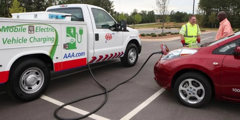

So theoretically, in reality, I would be screwed without my AAA card or a long extension cord?
