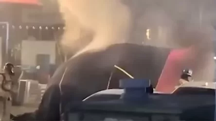

I had first thought that fire blankets would provide a solution for dealing with EV fires. Not that they put them out but rather, they limit spreading the heat effects. But it turns out the generated gasses are spontaneous combustable. The blanket traps the gas and upon exposure to air, a fire ball envelopes the too curious fire fighter:
The blanket traps the hot, combustable gasses, primarily the electrolyte, and upon exposure to air, a sudden flashover occurs. The bubble of gas under the heat blanket needs to be treated very carefully and several thoughts come to mind:
  • pilot pipe - pushed under the blanket with a valve than can be opened to release the combustable gas into a 'burner' like we see at oil refineries.
  • center vent hole - same idea but built into the blanet that opens to let the gas release and combust in the center of the blanket.

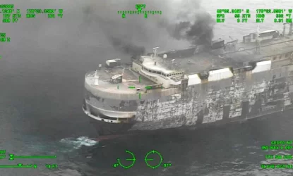

After EVs on the Morning Midas (Mourning Midas?) caught fire earlier this month, forcing the crew to evacuate their ship, this article described how EV-carrying ships could use cooled, concentrated, briny seawater to stop fires (but the article doesn't say who gets the job of piercing the EVs' windows to insert the hose that will deliver the cold, briny seawater):
Unlike traditional fire suppression methods – which act from the outside and often fail to extinguish the core fire – the brine system targets the battery directly from inside the vehicle. In the event of a fire, one window is penetrated, and cold, saturated brine is delivered directly into the cabin. This allows the fluid to pool around the battery compartment, rapidly cooling the cells, limiting oxygen exposure, suppressing flammable materials, and even short-circuiting and depowering the battery.
“We believe this system sets a new standard. It’s low-tech in the best way – reliable, proven, and easily maintainable. Most importantly, it addresses the real issue: heat – not just the flames, but the fire inside the battery” said Finn Wollesen, managing director of Knud E. Hansen.
In a full-scale fire test conducted in the Faroe Islands, the system extinguished a fully developed EV fire in under one hour, including response times. In contrast, lithium-ion battery fires often burn for 24 hours or more when left to self-extinguish, and can reignite multiple times.
