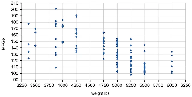

I combined the 2021 and 2022 data for electric vehicles: https://www.epa.gov/compliance-and-fuel-economy-data/data-cars-used-testing-fuel-economy

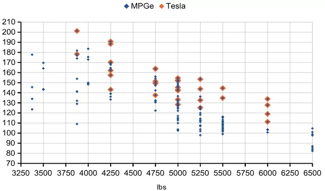

So I plotted the MPGe vs test vehicle weight to get this chart:
I dropped any below 60 MPGe since such inefficient vehicles might as well drive around with their brakes on.
There appears to be a sweet spot between 3750-4250 lbs (1705-1932 kg). Above this weight, the efficiency takes a dive. Below that weight, the vehicle size probably has aerodynamic problems leading to less efficiency.
ps. I'll try to attach the spreadsheet embedded in a zip file.
I made a fresh chart using the same spreadsheet using one of two test protocols and plotting both MPGe and "Tesla" MPGe:
Tesla engineering is focused on vehicle and drivetrain efficiency. The other EV makers with legacy design rules, not so much. My suspicion is they outsourced the drivetrain technology but it could also be legacy design rules.
Tesla engineering has a moat, absence of ICE legacy.
Tesla is very, very good at designing to the test and is able to publish better numbers accordingly.
Opening up more of the battery and then telling people not to use it is one example.
Don;t get me wrong, they make some of the most efficient vehicles out there, but looking only at the EPA numbers gives a bit of a distorted view.

Like I said, Tesla is very, very good at producing vehicles that do well on the EPA test cycles.
This makes it harder for the average owner to achieve those results in real world situations that don;t mach the EPA test cycles/conditions.
Tesla is not falsifying test info, they instead use that as their design goal.

I think we're saying the same thing. Tesla makes maximizing the EPA results a priority.
Where we differ is on how well that correlates to owners results after purchase.
Yes, you can drive in a very specific way to achieve the EPA numbers. With some vehicles you just have to work harder to do it. Tesla is at or near the top of that list.
I'm not saying that Tesla is doing anything wrong. They didn't write the rules and they indeed are following them very, very well. I've never quite figured out when/why the EPA stopped requiring a company that tells you not to charge to 100% (except on rare occasions) to derate the range rating accordingly (as per the original LEAF). Once again, Tesla is not gaming the system, they are doing everything they within the rules to maximize the range number they can publish, and that usually doesn't result in more "real world" range.

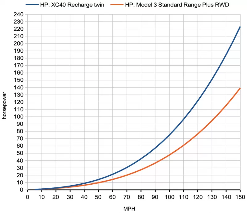

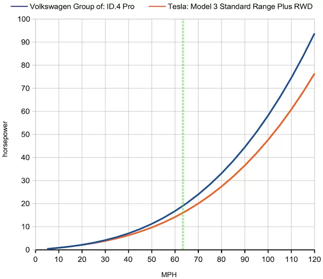

I am working on an Open Office spreadsheet that plots the 'drag power' as a function of speed and the three roll-down coefficients. Here is an early example:
I'm open to suggestions. My plan is to use the secondary axis for Standard Units, kph and kW. Reduce top speed to either 100 or 120 mph. Offer a two car or four car comparison charts. Add minor grid lines between the major. Add the EPA reference velocity, 63 mph, for highway MPGe. Hopefully, we'll get some good technical suggestions.
When it looks good, I'll share the Open Office spreadsheet in a ZIP file.
