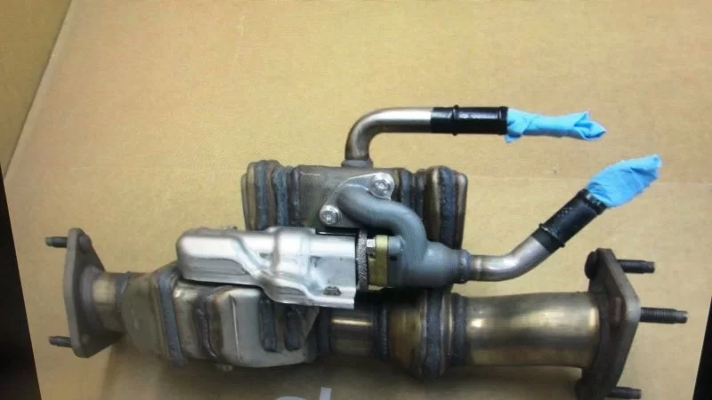

An exhaust heat recovery device is expensive (maybe $800) and the heat is abundant and free.
No electrical parts, just a coolant heat exchanger with an internal thermostat to route exhaust through a bypass pipe when coolant is warmed.
Picture attached of an Accord Hybrid "heat collector" which would only bolt up to that specific exhaust, but it has me thinking.
