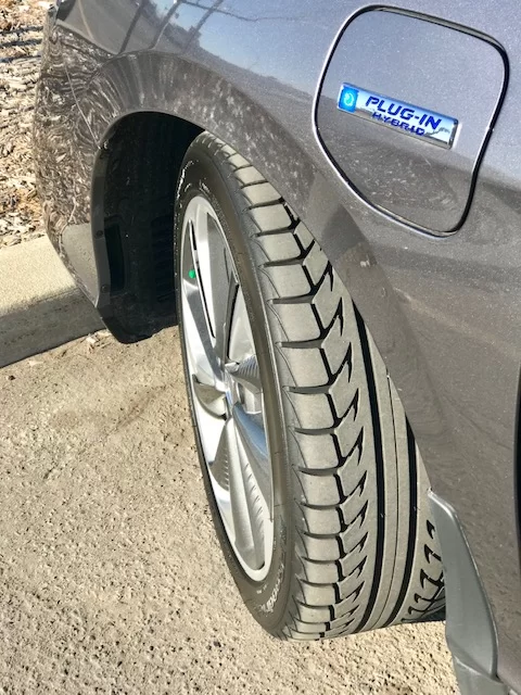

I replaced the OEM tires immediately with BF Goodrich Comp 2 summer tires. I paid about $1200 (Cdn) for them at Costco and sold my "brand new" Michelins A/S for $750. Handling was greatly improved (the car wallowed through tight corners before) and braking went from 120ft to 90ft for 100km to 0. Collision mitigation becomes collision avoidance. And we all know how much our insurance deductible is. They will probably last almost as long as the OEM tires, maybe one season less. Running all season tires and winter tires just doesn't make sense in Ottawa. My 2 cents.
That's a cool looking tread. I assume you weren't able to get any gas mileage data before turning them in so you could compare to the new ones?
The best I could do is max distance travelled on a charge - 103.2 Km which is comparable but not the best. I estimate I lose about 4-5% distance with these "higher rolling resistance" tires. Safety before economy though. :)
