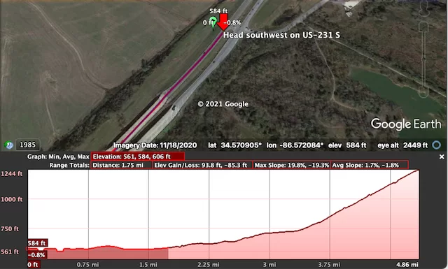

  • Flat segment:
    • 1st pass: 1.5 mi, 229 Wh/mi
    • 2nd pass: 1.4 mi, 226 Wh/mi

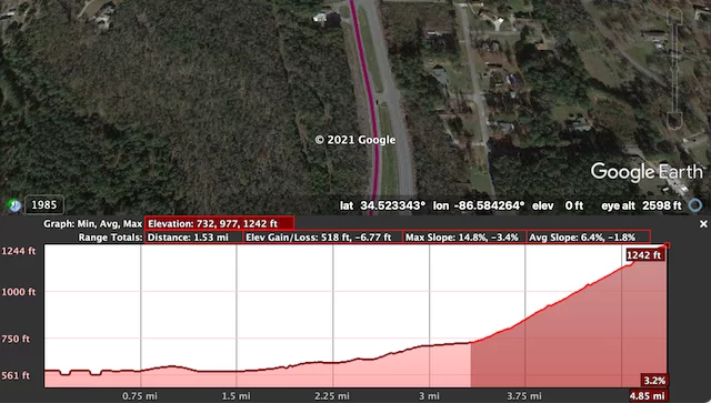

  • Hill climb and descent:
    • Climb: 1.4 mi, 776 Wh/mi ~= 1,086 kWh
    • Descent: 1.5 mi, -241 Wh/mi (charged) ~= -239 kWh
    • ~2.9 mi, 847 Wh, ~292 Wh/mi
    • 292 - 228 ~= ~64 Wh lost ascending and descending 525 ft hill
    • 121.9 Wh / 1000 ft or ~0.53 miles / 1000 ft

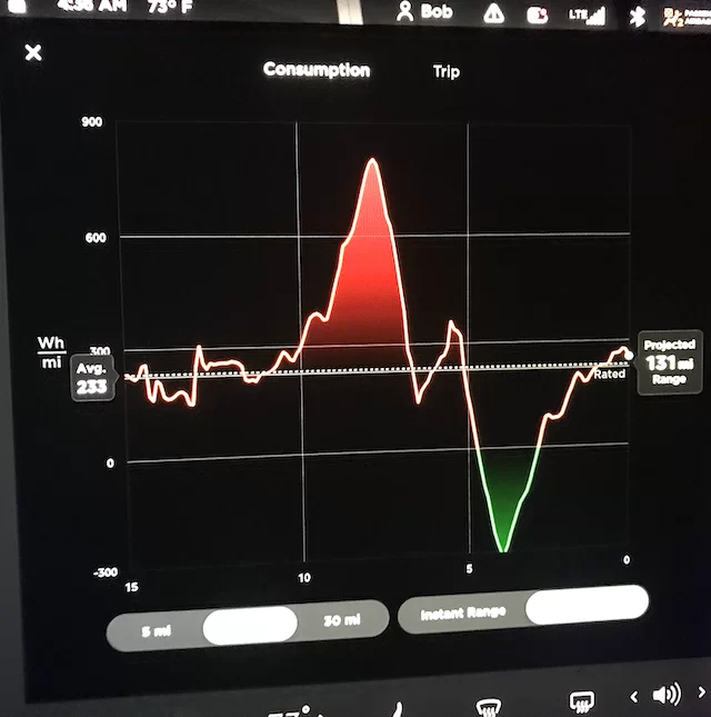

  • Vehicle energy graph:

Yes. First, I don't think you used over a megawatt-hour to go up a hill. Second, I'm not talking about
round trips, despite the usual truth that what goes up must come down. Reading between the figures,
though, it looks like you would lose ballpark 4.6 miles per 1000 feet rise, which is not bad. Maybe I'm
off with the mgh math. Does a M3 really only weigh 4000 lb loaded? That's on par with the Kona,,

  • Heart of Dixie Highway (Brindley Mountain, Hwy 231) - one of the few straight sections that has an ~8% grade, ~1.2 mi length, and 525 (160 m) elevation. There are taller hills but their former logging roads have hairpin curves. Regardless, it is my 'benchmark' hill as from a standing start at the base, I do a full power climb. Our past Prius barely reach about 95 mph at the crest. The BMW i3-REx is speed limited to 94 mph and reaches it well before the crest. The Tesla Model 3 exceeds 110 mph while accelerating and we have to heavy brake to avoid the 85 mph limited curve after the crest.

  • Flat segment:
    • Climb: 1.4 mi, 776 Wh/mi ~= 1,086 Wh
    • Descent: 1.5 mi, -241 Wh/mi (charged) ~= -239 Wh
