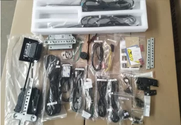

I researched and found most installation kits cost at least $500 and most are sourced in China. So I bit the bullet and ordered through AliExpress, one called "Better Smart Auto Electric Tail Gate Lift for Kia Niro 2017+ years, very good quality, free shipping!with suction lock!" which including shipping cost about $420. upload_2020-5-2_18-9-24.webp
The challenges are that the instructions show only major steps and you need to be brave in popping off the interior panels, figure out how exactly to insert the hardware and trust that the different strike, latch and other parts do fit and align properly. I've had to cover holes where the bumper tops were removed and taped around the reduced size latch, otherwise it looks fine and functions properly.

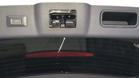

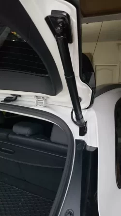

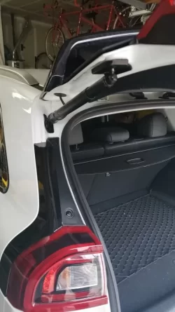

Here are some photos of the switches and the new electric-motor struts, on my Niro EV auto liftback.
Rather than placing the tailgate button to the right of the hand-hold, I decided to move it to the left, to balance out the lift edge. This meant that the switch, which comes with a plastic nut on a threaded sleeve, has a sleeve-size hole in the plastic panel and a nut-size hole in the metal back. No spacing for the nut to be between the liner and the structure and no way to thread/unthread to get behind the structure when attaching the panel. The electric-motor structs are noisier than the air shocks, but that's what moves the liftback/tailgate up and down. Nice to have the tailgate automatically sucked close.

You had to cut small rectangular holes in the dash and door trim to install the control buttons or do they somehow stick to the surface?
No - the 2 buttons are rectangular but have hollow circular bases and adhesive backing. Kit comes with a circular hole cutter on a drill bit. Requires a hole to be drilled in the plastic panel to mount the buttons, with clearance behind for the plastic nut. This circular threaded base is required because the wiring needs to pass from the button to the rest of the system. Everything is hard-wired - see attached photo from the website.
The cutting drill is contained in the rectangular box in the lower right.
