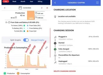

I already ran the test on Dec 24, 2022 and it's a power hog. In the morning I was running errands and had 30% e-power the entire morning. Charged at noon and set a departure time and was at 100% e-power for 7:26PM departure.
I forgot the temps, but it was about -15F and the SE was parked outside connected to my EVSE (20A derated to match my 5kW home battery output).
