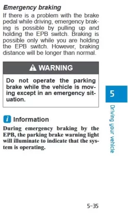

Edit : read the manual, three times it mentions not to use the EPB while vehicle is moving as it may cause damage, but a little blurb on page 5-35 says
" If there is a problem with the brake pedal while driving, emergency braking is possible by pulling up and holding the EPB switch. Braking is possible only while you are holding the EPB switch. However, braking distance will be longer than normal"
