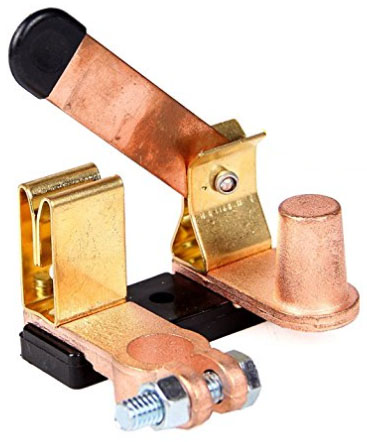

Sorry that you had problems during your pleasure trip to the mountains. I'm thinking it might be wise for me to carry a wrench in the car, just in case, but I think I remember a reference to a fuse that can be pulled and reseated to accomplish the same reset. If anyone knows if that is factual, and can share which fuse it is, it could be a valuable bit of knowledge to anyone coping with warnings while in transit.
Perhaps Honda would get the message if service technicians began finding these switches installed atop the battery of every Clarity they work on. Just kidding; Honda isn't in the message-getting business.
If anyone does install one of these very tall switches, please post a photo of what your aluminum hood looks like after you close it. Actually, there are much more sophisticated compact battery disconnect switches available. I just liked the basic look of this knife switch--something you'd expect to see in a Frankenstein movie.
I’ve seen a lower height cut off switch in the auto parts stores ans at Wally World that has a knob you insert and remove. I think it’s more for anti-theft or long term storage uses but would work easier and with less wear and tear in your connections. It’s less than $10 and there are more expensive ones as well.
