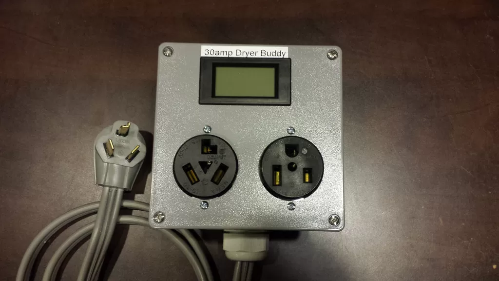

Hello.. I am an new Kona Limited EV owner and wanted to know if anyone here has had experience ordering a Dryer Buddy or similar device to switch between dryer and EV plugs? Thanks.

I have built and used devices similar to the "Dryer Buddy" First the negative side. Where I live in California they do not meet the building code and are therefore are not legal. In addition the "Dryer Buddy" does not list and certifications such as UL listing. Therefor if there is a problem is caused by the use of a device like this then an insurance company would not cover it as it is an illegal and unapproved device.
Will it work. Yes if done properly. In my case I used the device as a temporary means while I was building a new garage with proper wiring and dedicated circuit breakers. I used a spare circuit breaker box with a breaker for the dryer and a breaker for the charger each one independent. I added a plug to the box that I plugged in to my existing 14-50 welding outlet. All the wiring in the box exceeded electrical code requirements. I only used one device at a time. I also closely monitored it during used for any problems or excess heat.
If the "Dryer Buddy is code legal in you area it could be a in expensive option to re wiring. However a lot of areas have rebated that cover the expense of installing a dedicated circuit and plug. Where I live Southern California Edison has $1500 in rebates that more than cover the cost of proper installation of a new plug and circuit.

Also, I've added a pic of one version of the DryerBuddy, but their website seems to offer a number of variations now.

I'm sure that the Dryer Buddy will work just fine even though it's not the preferred solution. Again, it all depends on your setup and how close your breaker panel is to where the car will be parked.
