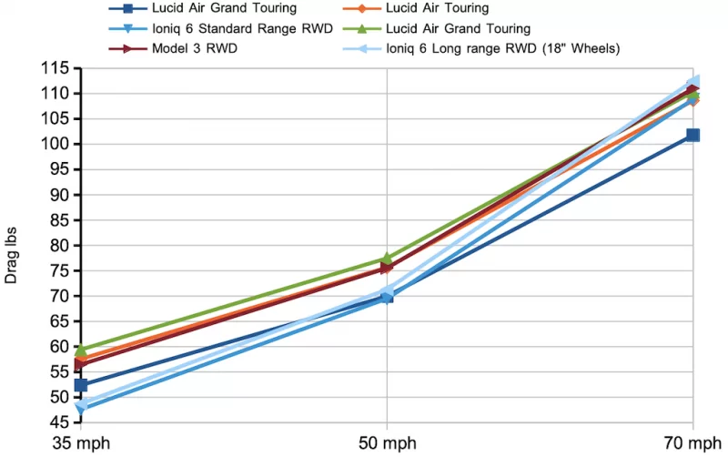

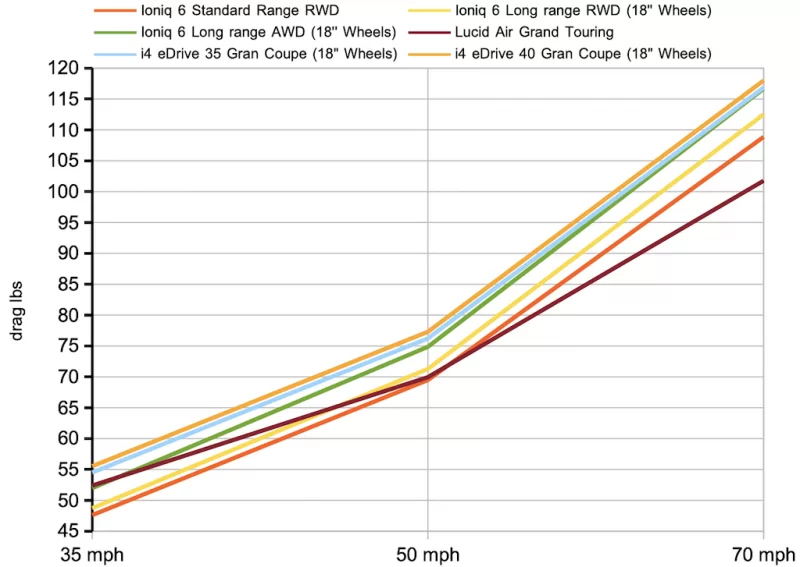

So here are the top six vehicles at these three speeds from best to worst.
35 mph
50 mph
70 mph
Discussion
The Lucid and Ioniq 6 show up in all speed ranges, 35, 50, and 70 mph. The Teslas show up in the 50 and 70 mph range. The i4 shows up in the 35 mph, urban range. Given the reported price differences, the lower cost Ioniq 6 should take sales from the more expensive Lucid. The Teslas need to reduce their low speed drag which can be done by better tires and lower weight.

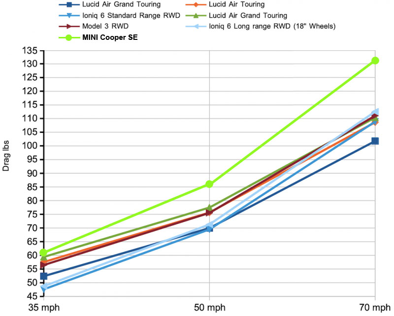

Is there another variable involved in calculating this beside coefficient of drag and frontal surface area (besides air density)?
Thanks @bwilson4web for those illustrations, but such a tight bunch of lines! I added my reference brick just to see some separation. I'm sure my 2000 Honda Insight would have done much better, but it was nowhere as much fun as my MINI Cooper SE.
I guess weight might be a factor here too, right?
Also, wheels make such an amazing difference--both dead weight and, even more importantly, rotional weight, which affects acceleration even more than dead weight (something bicyclists who have experienced super-light wheels can appreciate).
The roll down coefficients are not 'coefficient of drag and frontal surface area.' These EPA coefficients come from getting the vehicle to speed and then accurately measure how the vehicle decelerates.
It is an involved, detailed process but gives trustable results. For example, at least 10 roll down tests are run and the results averaged. I tried it once using an iPhone GPS App and it is a bear!
I was trying to find a way to quantify tire rolling resistance. Although real, I could not get metrics that came even close to the EPA coefficients. I still want to do tire rolling drag testing.

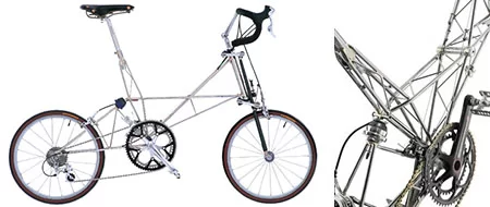

I believe the effects of rotational inertia on lighter bicycle wheels are easy to detect because you feel faster. In the 70s, I was amazed at how much easier it was to accelerate with 200-gram rims and 200-gram silk sew-up tires, but that delicate combination that wasn't for everyday riding. Decades later, I found another way to reduce the rotational inertia by getting a Moulton Speed bike with 20-inch wheels (Alex Moulton helped design the hydrolastic suspension for the first Mini).

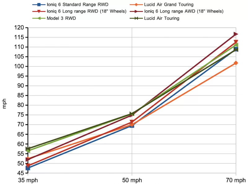

My benchmarks before with the Tesla OEM wheels and tires compared to the lighter, open spoke, and lighter Bridgestone ECOPIA tires showed reduced power needed under 45 mph and more power needed above 45 mph. Also, the EPA roll-down coefficients reveal a low-speed performance impact:
The blue line shows the Tesla drag force at lower speed has a higher than expected value compared to the high speed drag force.
