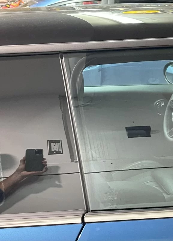

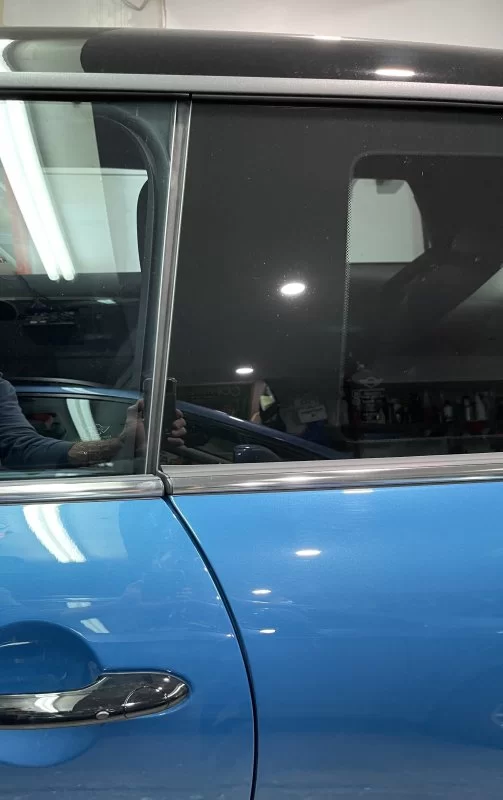

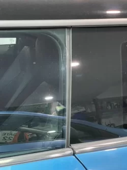

Last night driving home I noticed some creaking noises, as we all know the sound in this car travels so they could be from anywhere; what sounds like it’s coming from the corner of the windshield or the A-pillar might actually be coming from above the door or the B-pillar. But I just walked around my car and noticed that the gap between the driver side window and the rear quarter glass is rather large, so I double checked the other side and it looks much narrower. My window drops and raises when I open the door as expected, so I’m truly wondering what the problem might be. Anybody else seen this? I thought the LCI/2 F5xes were noted for their panel alignment and QC (but this is something I never noticed).
Driver side:
Passenger side:
When I grasp the window pane on the driver side there is play, it can move up about a quarter inch at the front, and correspondingly towards the upper aft by about the same amount, the fulcrum seemingly somewhere near the middle. There’s no such play on the passenger side.

There's slop no matter what, for various reasons. When the regulator stalls up into the top header that's when you get your tight fit.
The Mini windows are frameless which looks cool but provides a lot of extra challenges. Usually the glass is clamped in and there's a lot of (required) adjustment you get from loosening the clamps and shifting the glass. That has to be done in a per-car basis at time of build.
Technically the B-pillar seal only contacts the inside of the window so the fore-aft position doesn't matter, but it does look like the glass is not quite sitting fully on the seal on your car.
I kinda doubt this would make a creak noise, more likely to make a whistle at speed, but you never know. To fix it, they'll have to shift the whole glass rearward. Due to geometry that also means your glass will either be able to go higher or you'll get a worse seal at the A pillar, depending on the current limiting factor.
