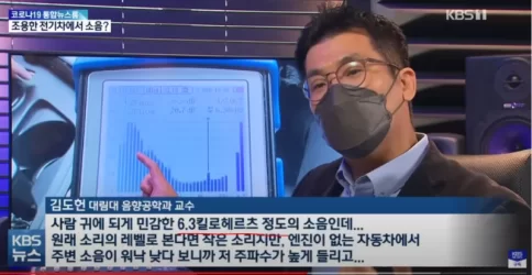

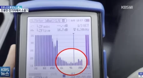

Let's check out how high-frequency sounds are on this meter with a sound expert.
When driving at a speed of 10 km/h or less, sound is detected for each frequency.
Then suddenly, a bar graph near 6,000 Hz pops up.
At the same time, a high-frequency sound begins to be heard for over 3 seconds.
People usually perceive sounds between 4,000 and 17,000 hertz as high frequencies.
A sound of 6,000 hertz is a range that anyone can hear well.
[Kim Do-heon / Professor of Acoustic Engineering at Daelim University: "It is a noise of about 6.3 kilohertz, which is very sensitive to the human ear... It is a small sound in terms of the original sound level, but the low frequency is high because the ambient noise is so low in a car without an engine. I hear…”]
